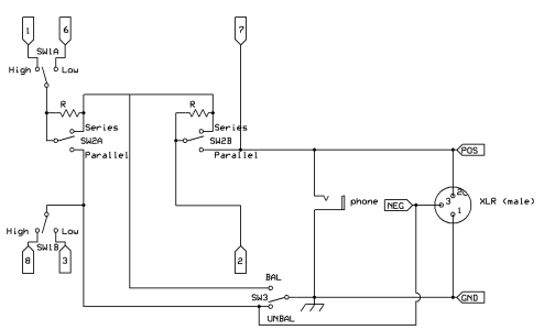

The transformer is not designed with one continuous secondary winding; the impedances are made up with parallel or series combinations of sections. That's why it took three double-pole switches for each transformer.

To add to PJ's comments about his secondary designs, if you have a tube amp with binding posts for 4, 8, and 16 ohm speakers, only half of the copper on the secondary is used when using a 4 ohm speaker.  This issue can be circumvented by having multiple windings and placing them in series/parallel arrangements to get what you need, or a couple of tapped windings.  The downside to this is cost and convenience.

Because I don't understand how the OT wiring works, the idea that an impedance switch for the SII requires only 3 On-On switches for each OT is completely baffling.
In my attempt to figure out an impedance switching mechanism for the SII, I have treated the OT as a black box and assumed that for each of the 4 impedance wiring schemes (2, 4, 8, 16 Ohms) only those connections indicated in the manual may be made. So far, the only on-paper solutions I have come up with are: (A) one 2-polethrow, one 3-polethrow, and two On-Offs; or (b) a four position quad deck rotary switch that simply combines the previous solution into one switch.  Not very elegant.  And neither of these include a switch for balanced/unbalanced!

Two, two pole switches will provide 4 possible combinations (2,4,8 and 16). Plus 1 switch for bal/ unbal. Right?( Both down, 1up 1down, 1 down 1 up, both up).I don't know the details of how the secondary windings were connected but I can imagine that the switches connected them in series or parallel to produce the desired impedance at a given switch position.If you knew the details of the OPT construction it would probably be easy to figure out the combinations, but I think that information is probably considered to be proprietary.

I think I figured out where I went wrong - I confused double pole with double throw and was trying to solve the problem with SPDT switches.  I'm going to rework the problem using DPDT switches - that should hopefully get me down to 2 switches.

It's not a secret, I think this has been posted before. Here's the circuit. They are DPDT switches, except the balanced/unbalanced which is SPDT.

Even just as a solution for impedance switching (leaving aside the bal/unbal part of the circuit), that is a very clever solution. It would have taken me a good long while to come up with it - and most likely I wouldn't have and instead settled for using more switches. Many thanks for sharing this, PJ.

Haha! Yes, it took me a good long while to sort it out as well.
