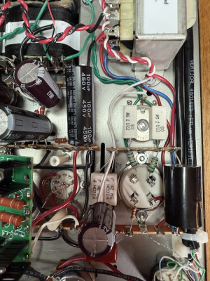

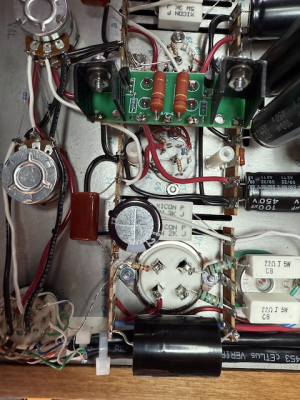

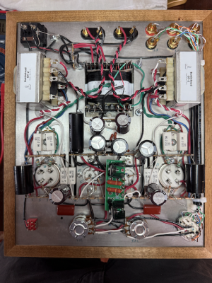

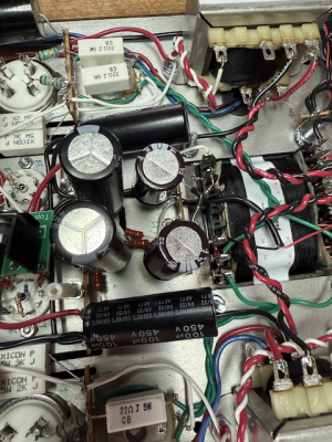

Just for the sake of double checking, maybe post a picture of the underside.  There are minor errors that can be made that will suck out all the bass but won't present themselves as DC voltage issues.

Dang PB!  You're fast!!    Appreciate the help!
Let me know if any other specific views/angles would be better . . .

You'll see one "woopsie" I had and trimmed one of the 130oh resistors too short - 2 of them go into 44L so I wrapped the lead of one around like the rectifier diodes and did a short extension of some bare buss wire so it'll look like only one 130 going into 44L  but both are there.

I don't see anything super obvious, so I'd leave it playing for a while to let it break in.
The SEX amp does have a bit of a low frequency resonance that bumps up the bass a few dB, so that may be what you're hearing.  I'd definitely double check that the 249K resistors are the correct value as well.

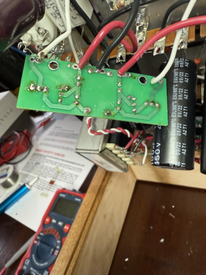

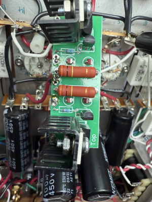

Today I had to putz around troubleshooting after doing the shunt regulator mod and loosing my left channel. Got that figured out and wow, another big step up!  I'm really loving it now.  Started playing around a little with my speaker placement and holy cow!!! I must have been in a bit of a null point or something because just tweaking the speakers another foot into the room and things got REAL.  The bass all of a sudden came alive in an amazing way. The whole thing just blew me away honestly. I'm running some vintage Altec 604s and these things are amazing but very very unforgiving speakers. If anything isn't just so, they let you know about it.
