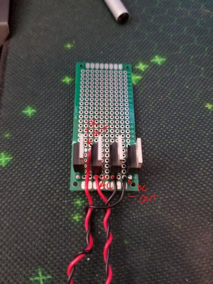

Reply #2 on: December 03, 2017, 06:22:18 AM
Caucasian Blackplate i made few pictures. Please don't rant too much because i made place adjustements for few components. The wirings should be the same (checked several times, should be OK everywhere)
Maybe a quick look for mistakes, please?
Made a pic of phone jack for you, i think it is thouroughly soldered though.
Re-measured voltages from page 29 again
Power transformer pins 7-9 (green wires) = 6.5V
Power transformer pins 11-12 (berofe diode bridge) = 178V
this means i got wirings for 230V mains correctly?
and all further power consumptions (after bridge rectifier) should receive proper voltage, right?
Aaaand again re-measured control voltages.
Still the same (as in 1st post) = huge numbers: 180V, 389 V, 237V
Afraid to even switch it ON, not even talking about plugging some cans and try to play music.
Help, what to do.

Reply #3 on: December 03, 2017, 02:39:44 PM
I'm sorry, I can't provide any technical assistance when the kit is not built according to the instructions in the manual.
