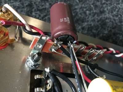

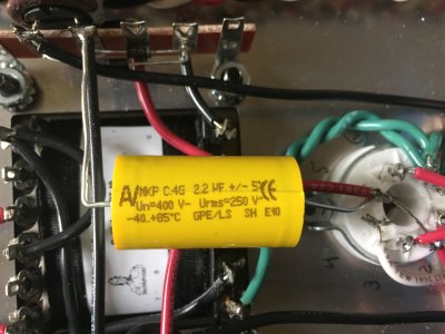

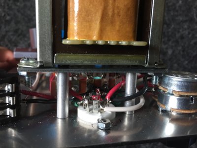

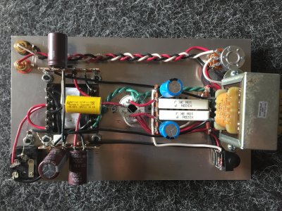

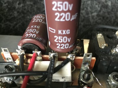

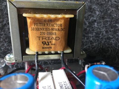

Posting some detailed photos of your build could be helpful in this scenario.

I went over the connections again and reflowed most of them. The distortion improved (but didn't disappear) for a bit, but after ~1hr it was noticeable again. I took the large board off and am planning on touching up those connections, and maybe even replacing the wires connecting the board to the terminal strips (didn't have strippers small enough for that wire, and worried that I might have damaged/weakened some of the wires while stripping with the cutters. Picked up a new, smaller gauge wirestripper today). In the meantime, I've attached some detailed pics that may offer some clues (the extra red and black wires coming out of the 9pin socket are for a 6V indicator lamp I added so that I'd stop forgetting to turn the amp off).  Really appreciate the help on this!
    • Posts: 9790
Reply #7 on: September 07, 2018, 10:47:16 AM
We really need to see the underside in some fully assembled form, either with the small board and cathode resistors on the big tube, or with both boards installed. Also please disconnect any mods to the stock circuits like the lamp. We are able to triage this stuff online only if the circuit looks like what the finished circuit looks like in the manual. Otherwise there are too many deviations to be able to say what might be out of spec.
