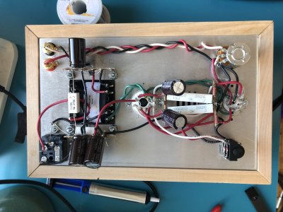

Oh I see. Actually I have no more wires left, here is my crack 1.1:
Quote
imgur (dot) com/a/mNGB73g
So are the extra wires free or I have to pay for them?

There should be a small coil of red, white, and black wire with the Speedball kit that is slightly different wire than provided with the Crack.
I had thought that perhaps you used this wire in the assembly of your stock Crack, but that doesn't seem to be the case.  (It looks nice BTW)
