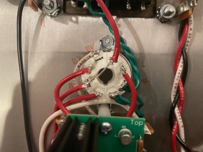

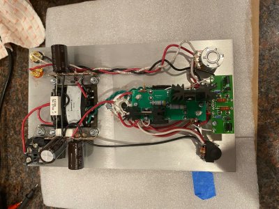

I recently built my Bottlehead Crack, and would like to make a modification to get more use of the volume knob.
Right now, a comfortable listening level is at about 15%, and the channel imbalance only stops at around 10%.
I read about adding some 33k and 75k resistors in-line with the pot, but I'm still not quite sure what I need to do exactly.
In my attached image, some someone please explain the number of resistors I need and the exact connections I need to make?
Much appreciated!
Side note: I also have an Alps RK27 pot that I might add sometime soon. Would that install (with resistors) basically go the same way?

Reply #1 on: January 13, 2023, 11:16:33 AM
There's a photo at the end of the FAQ post here:
https://forum.bottlehead.com/index.php?topic=4295.0
The RK27 complicates this a little bit because you also need to add a PC board to that pot in order to use it with wires, but the resistors will function the same way with that pot that they do with the stock pot.

Ah, thanks! So it should be:
  • 75K at 1U
  • 75K at 1L
  • 33K between 1U and 3U
  • 33K between 1L and 3L
For the RK27, that's actually what was keeping me from installing it right away! Well, other than cutting down the length of the pot shaft.

Reply #3 on: January 13, 2023, 11:30:19 AM
I would get RN55D resistors (not on cut tape, just loose ones) for the RK-27 install.  They have really long leads and should stretch across that PC board without giving you a ton of trouble.

Reply #7 on: January 14, 2023, 07:14:30 AM
Hi Paul, Will this padding scheme work with the S.E.X. amp as well? The amp I use in my my home office is always playing in the background. Often times it takes a lot of fiddling to find a good low volume/channel balance position.
Reply #8 on: January 14, 2023, 07:25:59 AM
Sure, you could put these on the SEX amp.
