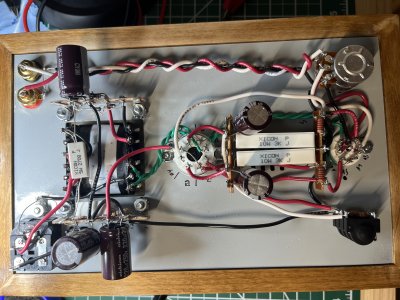

My kit with the speedball upgrade is not producing any sound on the right channel. So far I have measured all the voltages and the resistances that I will list below. I have checked that all the LEDs light up and both tubes also illuminate. Could this be a faulty headphone jack? I wanted to check before I replace the headphone jack thank you!
Speedball board (L & S)
OB & OA resistance OL
OA 104V 94.9V
OB 119V    87.5V
G 3mV
B+ 191.8V
Crack Resistance
1.    4.9M
2.    5M
3.    .3
4.    3.5M
5.    4.8M
6.    .5
7.    OL
8.    .3
9.    OL
10.  .4
12.  .2
13.  .5M
14.  .3
20.  .2
22.  no connections here? 0.L
B3.  OL
B6.  OL
RCA Center Red 93K
RCA Center Black 94.9K
RCA Ground Tab .5
Crack Voltage
1.    91.5V
2.    192V
3.    3.3mV
4.    192V
5.    86.2V
6.    .9mV
7.    117V
8.    3.5mV
9.    101V
10.  3.4mV

So novice mistake on my part. I thought I was getting both channels because I got audio on both side when the headphones were partially plugged in. I know now I was getting the left channel signal on both sides. I wanted to check here for any suggestions on things I could troubleshoot before I reverted it back to the base kit. I would need to purchase some extra parts so I would have some dwell time to troubleshoot.
* Also I tried to attach jpegs but it would not post to the message board so I am replying without the images.

Reply #4 on: December 21, 2023, 01:59:17 PM
Yes I'd assume that the kit did not work properly prior to speedball since I have no way to prove otherwise. I figured I'd need to revert but wanted to check just in case. I've attached the images in case it helps.
Reply #5 on: December 21, 2023, 02:08:26 PM
I can't really offer a lot on this one since it's so far from what we send out with our kits.  The Alps Blue potentiometer is only supposed to be mounted to a PC board, which is why it has PC pins.  If you want to use it in one of our kits, you'll need to get a little companion PC board off eBay to mount to the pot, then solder the wires to that board.  If you don't do that, the wires can just snap off the pot pins randomly.
Big caps in these amps can also pull things around.  If those aren't glued down, I would expect them to cause a bit of damage over time.
