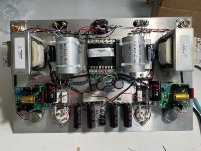

I got my top plate back from the powder coder. Initial instructions were to only powder coat the top side. But he did both.
What are the ground locations that I need to ensure are cleaned?
Anything other than the obvious?
    • Posts: 20290
Reply #1 on: May 04, 2025, 04:57:50 AM
The screw near the IEC power entry module, the central star ground point by the rocker switch, the four holes around each 9 pin socket, the holes where the trim pots mount (the metal body of those pots needs to contact the chassis), and the two screw holes by each set of binding posts.
