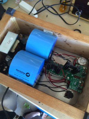

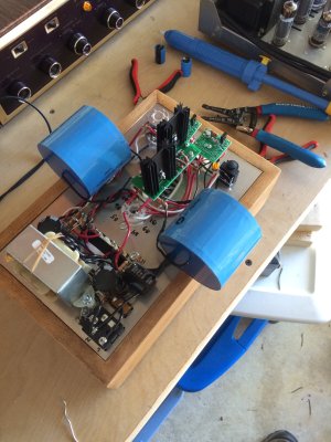

Hey everyone! Recently installed the speedball on my crack and I'm have a few hairy and harrowing issues. Firstly, I did not use my crack very much before I installed the speedball, so I can't accurately comment on whether the problems existed before installing the speedball. That being said, I have the following problems:
1) When my macbook charger is plugged in, I have bass in my hd 650s, but i have multiple frequency hums (high pitched buzzing, and white noise static). Occurs in different sockets in different rooms of my house.
2) When my macbook charger is unplugged, I only have a low hum, but I have no bass. Occurs in different sockets in different rooms of my house.
3) when turning the volume pot, I have crackling in my right earphone and generally the left phone goes out very easily.
4) when I fiddle with the headphone jack, i get can restore the sound in my left earphone.
5) with the macbook charger in, I get an additional high pitched buzz (maybe 15k hz?) when sending signal from my audio interface to the crack. I'm using a focusrite saffire 6 as a DAC.
All the voltages are correct and I have gone back and resoldered 10 joints or so. The only resistances that differ from the crack numbers are that terminals 7 and 9 read infinite resistance and not 2.9k ohms. Also, when testing voltages, I had a large blue spark occur at terminal 20 or 21 (voltage is fine after) and a large white spark when testing the voltage at terminal 9. I can post pictures if needed. Any help would be wholly appreciated, as I'm stuck and sad :( thanks so much guys!

Thanks so much for the help guys! I don't have my cables on me right now, but I will try to get some soon. In addition, while checking voltages yesterday, it looks like a I blew the fuse and it also looks like a blown rectifier diode may be the problem. I'm going to replace these with 1n4007s if I can find them at Radioshack ( i think the big blue spark may have taken 1 or 2 of the diodes out). I'll report back after the rectifiers and fuse have been replaced. No smoke from the transformer after the fuse blow, so hopefully it is still working O.o

Okay so update. I have replaced 1 UF4007 rectifier diode with a 1N4005 that I believe was blown (another thread said I could probably do this - this is all I could find at Radioshack). Also, I couldn't find a 1 amp slow blow fuse, but did find a .75 amp fast acting fuse, which I am now using.
Altogether, the amp comes on, and the large tube seems brighter than before, but all the LEDs come on and all the voltages are all fine except for the following: A1 - 70, A6 - 75, B1 - 75, B4 - 70. Not sure if these are correct with speedball or not. I did manage to get a cord which allows me to connect my iphone directly (with an audio interface). With this now, I have no bass, but I can hear in both channels when the volume pot is turned high.
With the iphone plugged in, the sound buzz/hum is relatively quiet when at 50% volume, but no bass. I've checked all the grounds according to the stickied post and they are fine.
I have also gone back and resoldered any joints that looked possibly cold. The only other thing I can thing to do is the resistor mod on the volume pot outlined in the FAQ. I tested the large and small transistors as well, and those seem to be fine (all very high ohms, if they can be read at all on their 3 pins). Other than the voltages stated above, I can find no voltages or resistances out of the ordinary, even after following the ground stickied post as well. Any help would be greatly appreciated. Thanks so much guys.

Hello again everyone.
I really appreciate the help thus far. I have gone back and tightened up the screws. It turns out the screw at terminal 8 was a bit loose. However, tightening this had no effect on the sound. I went through and rechecked each ground point according to Doc B's guide - all are fine, once again.
The crack itself is dead quiet at 50% pot when there are no RCA cables in the inputs... I'm stilling have the same odd effects with the "grounding" of my iphone and macbook, respectively. This leads me to believe it's still some problem inside the crack/speedball, if two different sources have grounding issues (where the bass goes out, if the source isn't grounded by my hands). Also, I randomly checked the screws on the middle of the heat sink plates on the speedball main PCB - one read *, while the other screw read 0 ohms. Does this make sense? I can't see why they would have different readings. I also rechecked the resistances across the each of the 3 prongs (3 combos) for each of the transistors that are connected to the heat sinks - all read *, as expected.

    • Posts: 20297
The heatsink screw heads will most likely read 0 Ohms, but it's OK if they don't.
I'd still imagine there's a flaky solder joint or two inside the amplifier causing this issue.
