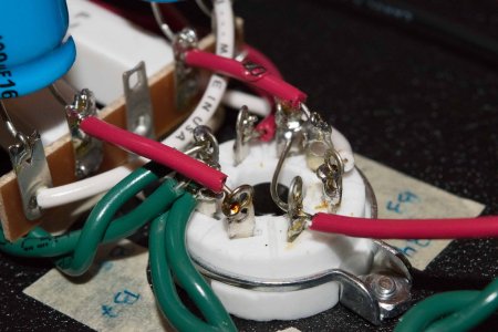

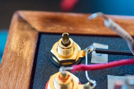

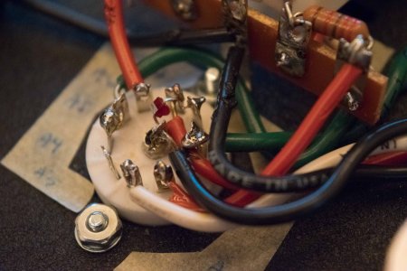

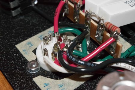

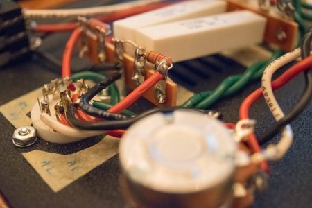

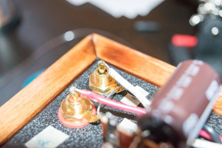

I ran the voltage checks for the Crack and was within normal limits for all terminals except T5 & T9.
T5 was approximately 148 (50-100V range)
T9 was approximately 146 (90-115V range)

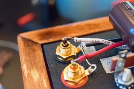

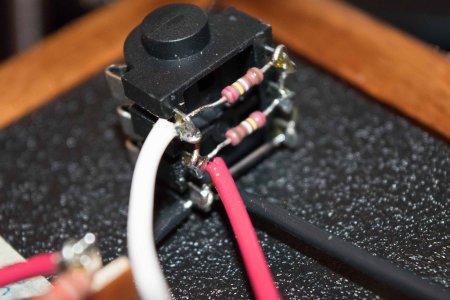

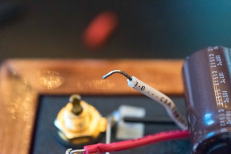

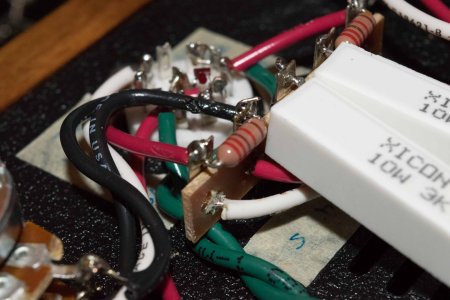

These both are quite above the 10% deviation range. I went over the terminals/resoldered all the connections (to each of those terminals) & when I rechecked the voltages I was still having about the same readings from my multimeter.
The wire that looks wonky to me is the RED from A1 - 5U, but I'll let you experts tell me what my plan of action should be since I'm amp illiterate.
Here's some pictures of my not so pretty job (warning: partially burnt wires ahead).

Have you installed both the LEDs on the 9 pin socket?
 Do they light up?
Offline Deluk
    • Posts: 441
Reply #2 on: March 25, 2017, 03:30:33 AM
The LED to A3 appears to be missing.
Offline BLACKPIPE
    • Posts: 17
Reply #3 on: March 25, 2017, 03:02:38 PM
I can't believe I missed that step. I was wondering why I had an extra led, I was thinking it was in case the other one was faulty. Oof.
Thank you both for catching my mistake!
All the voltage checks were within normal limits!
