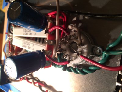

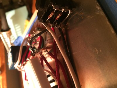

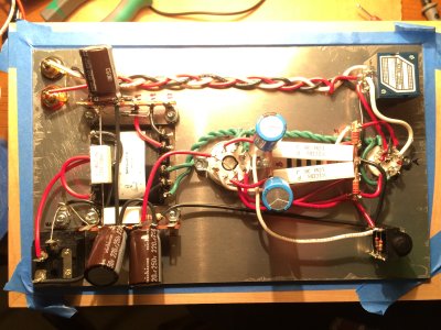

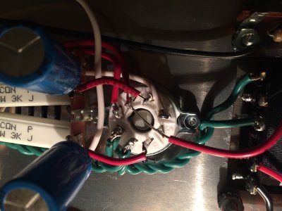

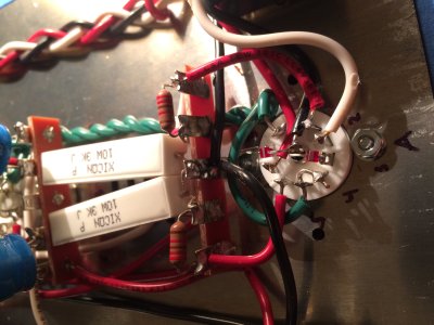

Hey guys,
Like the title says my crack failed the final voltage test. It passed 100% the resistance check however. I've made two quickies and some guitar pedals all with no issue but I'm sort of baffled on what's wrong with this crack. The 9-pin LEDs are not lighting. The heater wiring on both L and R seems fine, both plates (edit: heaters on both sides) of each tube glow normally. Here are the readings.
1: -.794 (should be 50-100)
2: -.796 (should be 170)
3: 0
4: -.8 (should be 170)
5: -.796 (should be 50-100)
6: 0
7: .0056 (should be 90-115)
8: 0
9: .0033 (should be 90-115)
10: 0

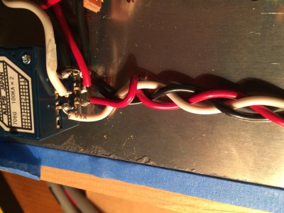

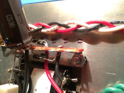

These decimal places are all in their correct spots. I'm extremely confused. Any help would be greatly appreciated. I'm attaching pics of the wiring. Thanks in advance!

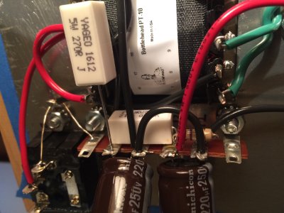

No worries on not responding that often. Thanks for the help. On the 21 side of the 5W resister lead I'm getting 240V, and on the 15 side of the lead I'm getting -.813V. Could I have fried the resister somehow?
Chris Littlejohn
Rega Planar 3 / Rega Exact Cartridge / Schiit Bitfrost Multibit / Brown Audio Labs SP-1B Preamp / Audio by Van Alstine Ultravalve Power Amp / Rega RX5 Speakers / 2 Bottlehead Quickies + PJCCS / Bottlehead Crack / Beyer DT1990 Pro Headphones
Online Doc B.
    • Posts: 9663
Reply #10 on: May 06, 2017, 09:53:38 AM
First thing is try resoldering the connections of that resistor. Could just be a cold solder joint. Unplug the amp before you solder.
Offline clittlej
    • Posts: 8
Reply #11 on: May 06, 2017, 10:17:30 AM
I resoldered and I'm getting the same readings. The joints are solid. Am I correct in thinking a reading of -.78V on the 15 side of the 5W resistor lead while the 21 side lead has a reading of 240V could mean something is amiss with the resistor?
Chris Littlejohn
Offline clittlej
    • Posts: 8
Reply #12 on: May 06, 2017, 11:52:11 AM
Update: I replaced the 5W resistor with a new one and now all the voltage readings are perfect. (edit: I must have fried it somehow, and I think I know when it happened. Not trying to say you sent a bad part). Thank you Doc for the help!
