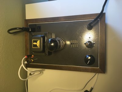

Reply #1 on: May 09, 2017, 03:28:34 AM
Here's a picture.

Nice work, the amp looks awesome.  And great job on the troubleshooting!
Enjoy the fruits of your labor.  By the way, it's guaranteed to sound better because you built it yourself.

I especially like the edge detail around the panel. Good job.
