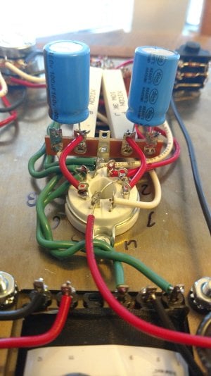

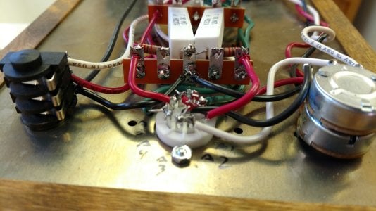

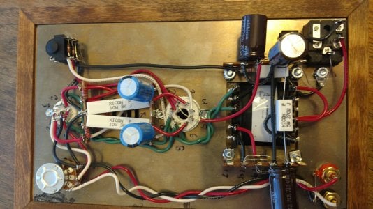

Reply #2 on: May 10, 2017, 04:17:02 PM
Here are some pics

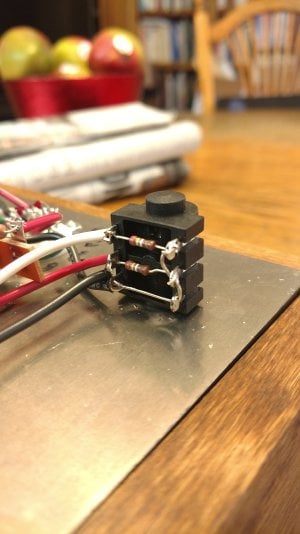

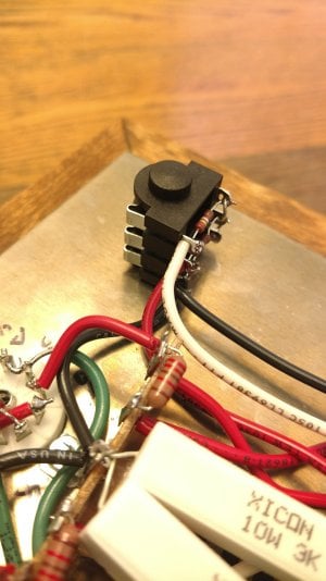

Reply #3 on: May 10, 2017, 05:50:13 PM
Could you take a clear picture of the headphone jack?
Offline billygood
    • Posts: 6
Reply #4 on: May 11, 2017, 03:10:41 AM
Here are some.
    • Posts: 9641
Reply #5 on: May 11, 2017, 06:24:40 AM
You may have a cold solder joint where the upper of the two black wires is attached to the headphone jack terminal that is closest to the chassis panel. Try reflowing that connection and remeasure the resistance.
    • Posts: 19694
Reply #6 on: May 11, 2017, 08:33:33 AM
Just finished my crack and Did the risistance check and passed all but terminal 6 and 10
They should both be 0 but both read 2.48k/2.49k
I went back through and checked and to my eye everything looks good.
What would cause this? Both point 7 and 9 checked out fine at 2.9k
The black wires at the headphone jacks are part of the ground buss.  The 2.49K resistors get shorted out when no headphones are plugged in, and your Crack is not currently doing that.  This is most likely an issue with the solder joints on the headphone jack itself, or terminal 3L.
Until this issue is resolved, do not attempt to power up or use your Crack.

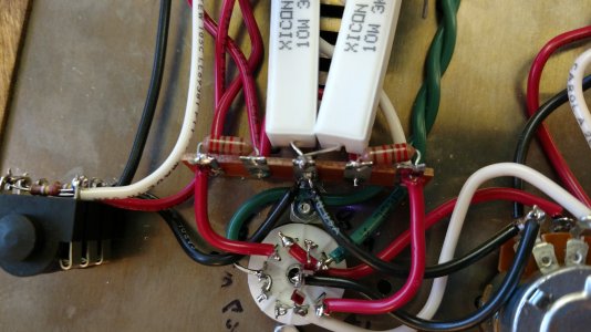

Reply #8 on: May 12, 2017, 05:14:11 AM
Some pics.

    • Posts: 19694
Reply #12 on: May 18, 2017, 08:10:39 AM
I would zero in on the junction of the black wires that meet at the headphone jack.  I would bet that one is loose and not well soldered in the bunch.  I would also check your solder joint at 3L.
