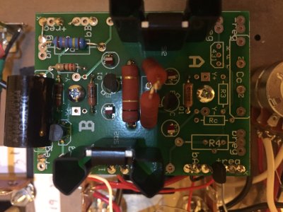

I have just assembled this weekend the Smash upgrade for him and one LED on the C tube board does not shine in the B side (D2 the one closest to bB). Please find enclosed voltage measurements.
Proper values            A tube       C tube
IA. 180-220                  198        199
OA. 150+/- 1%             149          50
+reg (A side) 2.5v            0            0.275
IB  150 +/- 1%             149          50.1
OB   45-75                      42         48.3
Kreg (B side)  3-5 v         4.16        3.81
B reg (B side) 150        148.7        50.1
+ reg (B side) 150        148.7        50.1
Measurements in B tube:
Proper values    Measured
B1  0v                    0
B2  150v               148.7
B3  3-5v               4.17
B4  0v                   0
B5 150v                50.1
B6  3-5v               3.81
Resistors in the boards been checked  specially 37.4 and 49.9 ohms are in place.
All MJE5731AG are hot after reading test but the one connected to the LED that does not shine is absolutely cold. All solders have been reviewed and re-wet.
I will try to replace the cold MJE5731AG next week.

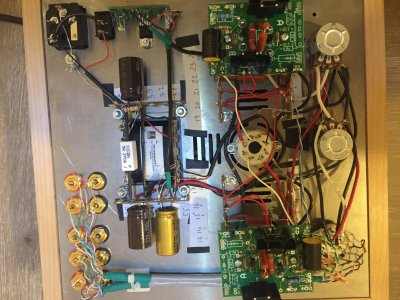

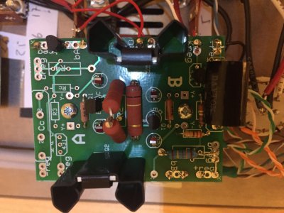

Please find attached some pictures of the Smash.
Please, do you have any suggestion?
Thank you very much in advance!!

    • Posts: 19745
Reply #2 on: June 08, 2017, 09:04:42 AM
The first things I would recommend:
Check that the LM431 and PN2907 parts aren't switched.
Check that the R1 resistors are correct on the PC board of the offending side.
You have one board that's working perfectly and one that isn't, so look for any differences between sides.
Offline Luisrecolons
    • Posts: 4
Reply #3 on: June 08, 2017, 02:47:11 PM
PB, thank you very much and excuse me for wasting your time with me!
Checking again the board, there was one lead of the PN2907 that was not neatly trimmed and bridged it (my newbie fault).
All readings are OK right now.
Thank you very much!
