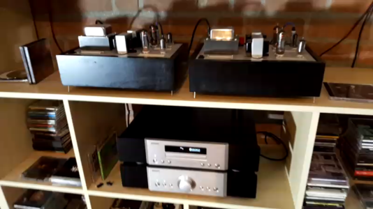

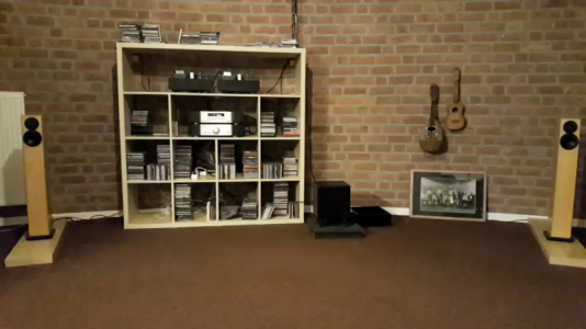

All equipment resides on an IKEA shelf. I've included a image of the system, shown without the smash but the preamp would reside in between the two power amps. (Sorry for the poor quality, it's a still taken from a video.)
Fun (but maybe important) fact: He lives in a new apartment which is directly connected to an old watertower. The system itself actually resides inside the tower on a separate floor.
