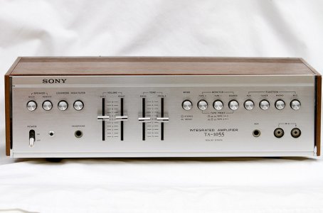

I have an integrated amp with a mono switch.  The ipod could connect to one of the inputs, then plug the headphones into the headphone out.  Would that work?

Did a test run with this unit.  Playing with the mono switch on brought back some of the sounds but not all.  Definitely an improvement though!

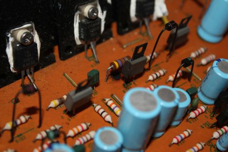

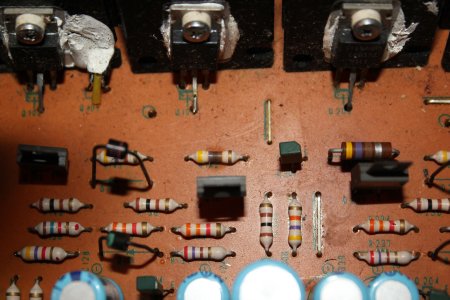

Found a suspect resistor inside, looks like it might be burnt?  It's R142.  There is also a large burn mark under a resistor in the second picture, but i'm guessing that isn't an issue.  Is it possible that R142 just needs to be replaced, and that's what's causing the crackling?  What would have caused that resistor to burn?  Based on the schematic, it looks like that is right after the driver stage.
Dave

Old amps are full of old caps.
Offline aragorn723
    • Posts: 1050
Reply #9 on: July 24, 2017, 02:47:15 PM
Very true.  I took a good look at all of the caps too.  A lot of them are the light blue Nichion's like the picture above.  Didn't see any cracks or anything unusual on them.  They all look newish, including the 2 big power supply caps.  Although electrically they could be no good.
