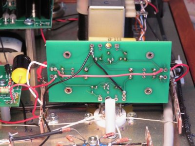

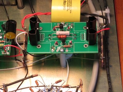

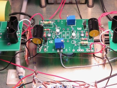

Here are photos:
http://imgur.com/CQ2c0wU
http://imgur.com/6tXGD0a
http://imgur.com/8tRqPAa
Thanks for any help you can provide.

You have missed a solder joint on the large high current C4S board in your photos.
Offline Larpy
    • Posts: 230
Reply #6 on: July 30, 2017, 10:19:23 AM
That was it!  How did I miss that?  I went over that board with a magnifying glass.
Thank you, thank you, PB.  After spending close to 4 hours last night and this afternoon troubleshooting, I was about to tear out my hair!
Everything measures correctly now and I've got the tubes biased.  Time to play some music.
