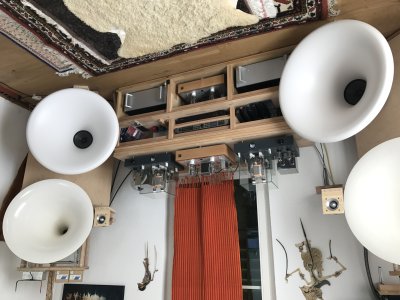

I am running a high sensitive speaker system with 2 Silvercore Monoblocks for the corner horns and 3 stereo Kaijus für low mid, mid and high. The bass is @ 102dB, low mid @ 104dB, mids @ 108 and the tweeters @ 105 dB. The Kaijus all have the psu upgrade and are dead quiet. It is managed via a Mini DSP to which the BeePre connects at the moment.
