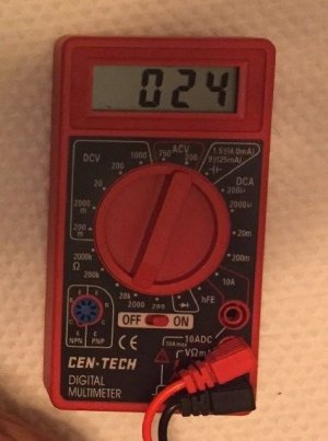

Hi:
I had a seller of an 8 ohm speaker measure the DCR and he sent back a photo (see attachment).  I'm not familiar with that meter but it looks like he has it set on the 20K range.  So what's the DCR (.024, .24, 2.4 or 24 ohms)?  Also, whatever the measurement is, would that reading scare you off?  I don't think it matters but the speaker is a tweeter.  Thanks!
Gerry
    • Posts: 20282
Reply #1 on: January 26, 2018, 03:44:08 AM
That's 24 Ohms.
I wouldn't be very excited about an 8 Ohm tweeter showing 24 Ohms of DCR.

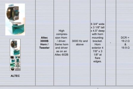

The plot thickens a bit.  The seller pointed me to a listing for a pair of 3000Bs on Oak Tree Vintage.  They were sold a long time ago but the notes indicate DCR measurements of 19.2 and 19.9 ohms (see attached photo).
This is just one other example but that makes four of these tweeters with DCR measurements greater than 19.  Again, this makes me wonder if that's what happens when these tweeters age and indicate that they might be going bad.  Of course the seller interpreted this to indicate that his tweeters measure "normal".

We can only guess what is going on here. A small increase like that could just be increased resistance of the solder terminations. But a lot of people don't understand how to get good contact on the test point with a test probe to eliminate added resistance at that interface. And the seller is not telling you what his meter reads with the probes touched together, so that that baseline resistance value can be subtracted from the 24 ohm reading to give you a (theoretically, at least) more accurate number.
Obviously it's easier to determine whether the measurement is acceptable if you have two drivers to compare, or if you can measure the driver with your own, known good meter. If you have two tweeters reading high but around the same value you probably have a better chance of them being good than if one reads a lot higher than the other.
So what is the answer? Buy it only if given the option to return it if it doesn't work right.
