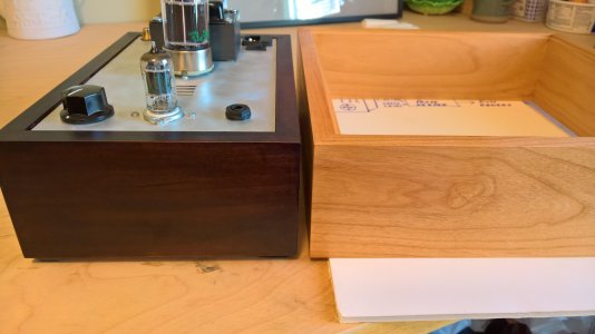

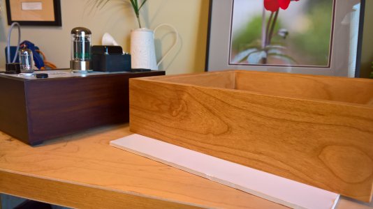

Heres a few pix of the Tung Oil (Formby's High Gloss, a small pint can size) two coats, going tp go to 4-5 coats.
The alder in the kit is "blonde" and light for sure..but it does darken the wood a good amount.
Compared to the dark walnut minwax stain on the Crack its lighter for sure.
Its all a matter of taste and what you desire, and can do with your painting skills.
The tung oil is really very very easy to do...
Alex

If you want a clear finish and want to richen the look and pop the grain, use an oil base finish. If you want the finish as light as possible, use a water base clear.

The oil does pop the grain nicely. Thank you Alex, and Doc. Decisions, decisions?

I put the third coat of tung oil on today.
Looks a lot like a light Maple color...like our kitchen Maple cabinets...
