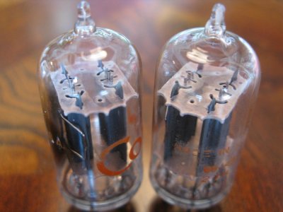

Reply #7 on: April 05, 2018, 03:16:27 AM
I took a look at a bunch of 12AU7 tubes and found this pix of "RCA Clear Top 12AU7's with the CONN label"
This is exactly what my 12AU7 looks like in the Mainline.
IF this is indeed accurate, many of the NOS tube crowd claim that RCA clear tops which are hard to find are the best sounding tubes in this class....
So here we have a tube that is being used in the voltage regulation part of the amp!
Wonder if taking this 12AU7 and using it in the Crack as the signal tube!
and using a different 12Au7 in the MAinline if the voltage range Paul stated is ok, a little mis-match doesnt seem to hurt~!

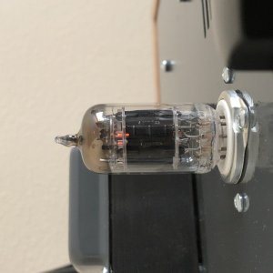

Here are my quick, initial impressions of the Mainline as compared to my Speedball-ed Crack, listening with the Sennheiser HD650's. Note this is based on less than an hour of listening on the Un-bal, High Impedance settings.
  • Larger soundstage
  • Clearer details
  • Well defined bass, but less quantity.
  • Less warmth.
Your Conn 12AU7 is what came with my Crack. You should definitely stick it into your Crack for a listen. The 12AU7 that came with my Mainline has no markings, but I think it's an RCA with black plates and triple mica.
Edited: Added picture.
-Raymond
