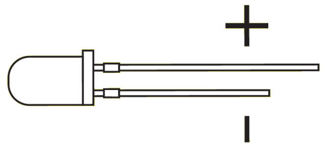

I just got some of the current HLMP-6000 LEDs for my broken Paramour (one of the C4S LEDs is open).
Is the striped end of the current LED equivalent to the longer lead of my ancient ones? These original C4S LEDs had one longer lead, not one flat side, to indicate the positive.
Offline patrickamory
    • Posts: 52
Reply #14 on: January 05, 2019, 09:20:57 AM
I think I figured this out by using my multimeter on the diode setting. The new LED lights up when the positive probe is applied to the non-striped end, so that is the anode? Which means that the non-striped end is equivalent to the longer lead in the original LED?
