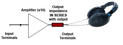

Out of interest, and I am sure this has been covered before but I couldn't find it, as anyone added resistors to the headphone jack of the Crack essentially upping the resistance of any headphone?  IE, add 300 ohm resistors so that HD600's become (in the Cracks view) 600ohm headphones?
That doesn't increase the resistance of the headphone, it just adds to the output impedance of the Crack (99.9% of the time this is a very bad thing).

I'm not talking about adding a resistor at the source, I am talking about adding it only after the output.  This could even be a dongle/adapter that plugs into the headphone jack of the Crack, and then your headphones into the adapter.
If it wouldn't benefit high impedance headphones, would it work for low impedance ones?
-Paul
Yes, that's what we have been talking about.  Notice the red resistor in the drawing that says "output impedance in series with output".  Again, any resistor you add between this output impedance and the headphones will add to the output impedance of the amp.
The effect PJ mentioned would be worse/more pronounced with low impedance headphones.
