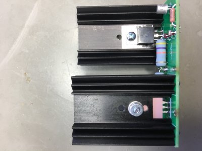

Can you pull the 6080 and remeasure the small board?

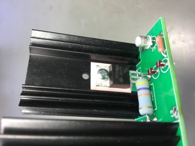

It is incredibly likely that you do not have the TIP50 transistors properly isolated from the heatsinks.  It's not just the insulating sheet that goes between the heatsink and TIP50, but also the shoulder washer that sits in the hole on the TIP50 metal tab and insulates the screw from the metal tab.

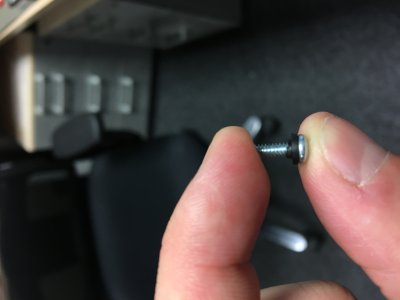

Reply #2 on: August 17, 2018, 08:55:31 AM
I pulled the 6080 out and measured the little board. the Voltages for the board are as follows.

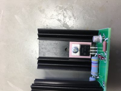

I am in Germany, so I have 230V mains. Ive also included a picture of the vinyl washer included with the kit.
It seems that part of it is not symmetric where it gets inserted into the transistor top. I have made sure I inserted it correctly, but Ill try it again and see what happens

Online Paul Birkeland
    • Posts: 20297
Reply #3 on: August 17, 2018, 12:30:27 PM
If it's not properly inserted into the TIP50 it will deform like that and you'll have the issues you're having.  I would recommend replacing it (and the other if it's deformed).

I am going to mark this as resolved. When i re-seated the washer, and angled the screw slightly more towards the side where the washer is not deformed, then the amp worked.
I've been using the amp now for a few hours now, and so far no problems. I;m going to order some new washers and replace the deformed one.

I'm still waiting for my new washers, but I replaced the metal screw and washers with a nylon screw and nylon nut.
After a few hours of use the same problem started happening again :/ So I am back to square one.

If the transistor isn't mounted properly, you'll get a resistance reading from the TIP50 metal tab to ground.  Almost always this is a condition that happens immediately, not after a long time of running.

I just ordered some new transistors and insulating tabs. Once they arrive, I'll completely replace the TIP50 for the left channel.

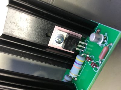

I've replaced the TIP50 transistor at at OA, along with putting in a new nylon washer and new insulator tab on Tuesday, and have been running it daily since.
It has about maybe 20 hours of usage since the replacement, and everything seems to be working fine now.
I guess I can make this as resolved again. It's too bad I couldn't isolate the exact cause of this problem, but I'm guessing it was isolated to this area.

And I uploaded a picture of it to show the difference
    • Posts: 20297
Reply #11 on: August 26, 2018, 05:40:02 AM
If they fit, that's great!  The tolerance is exceptionally unimportant there, provided the value doesn't creep up enough to increase dissipation.
The big challenge with the 270 ohm resistors in the Crack is that the one positioned between the two terminal strips needs to have sufficiently long leads to reach between the terminal strips, which your part does just fine.
The negative side of the parts that you've chosen is that the slightly longer body may not fit in the second position against the terminal strip.  For that position, I would let the lead be a little longer on the tube socket side of the resistor.

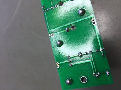

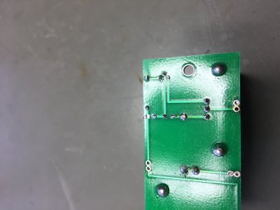

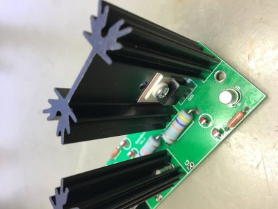

I'm going to take out the big board complete today and reinstall the two ceramic resistors, and then I will post some pictures of the big board from all angles. Maybe you can see something there that I can not. I just find it strange that the crack works for a few weeks at a time and dies.

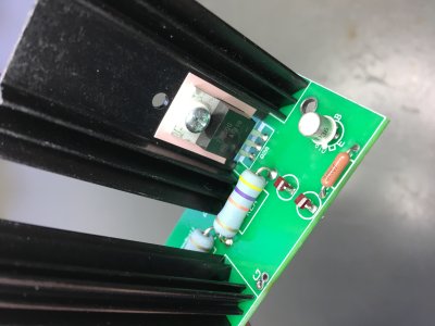

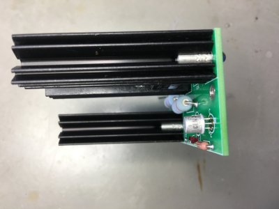

Offline Blue
    • Posts: 32
I have reverted to the stock crack, but left the small board inside. The voltages in the crack manual are all within their ranges including tolerances.
I'll play with the crack for another week or two to see if something strange happens.
I have now uploaded some pictures of the big board. Maybe there is something wrong there that I am not seeing?
« Last Edit: September 08, 2018, 04:50:46 AM by Blue »
