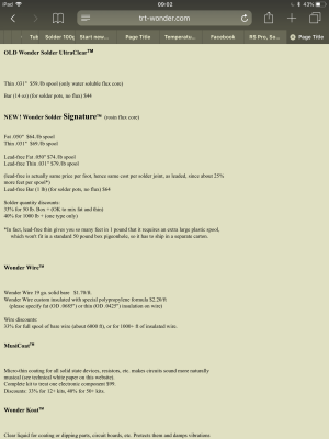

Russ highly recommends the use of TRT Wonder Solder  Ultraclear for its sound properties and the team uses this on everything they make.  I note from the attached data sheet that the flux is noted as ‘water soluble’ not Rosin.  Do you think this would be appropriate for my build? They recommend it but  Your instructions recommend Rosin flux...

Wonder is my favorite solder.  Flows like hot butter.  It is rosin core, just water soluble rosin.  Just  make sure you get the old leaded solder, not lead-free.

Thanks for your response on this. Is it the ‘Old Wonder Solder Ultraclear’ that you use? (As per the top of the attached list).  That’s the one that Russ Andrews has recommended.

It’s a shame that TRT don’t advertise any specifications for their Wonder Solder.  It’s meant to be mutts wotnotts but why would you choose it if you don’t know the specifics??  I reached deep into my pockets and paid for some Kester 44 leaded to be shipped from the Other side of the Atlantic!!
