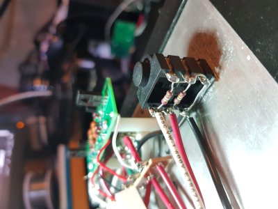

Also, before starting the upgrade, I forgot all about a noise I was getting from the amp that became a loud pop when I twisted the headphone jack in the jack socket. Suspect that was a bad joint but forgot to look for it before starting the upgrade.

Yes, I would consider it very likely that these are related.
When you examine the black wires entering the headphone jack, are they all well soldered, or perhaps is there one that's loose and one that's well soldered?

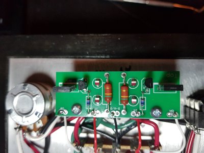

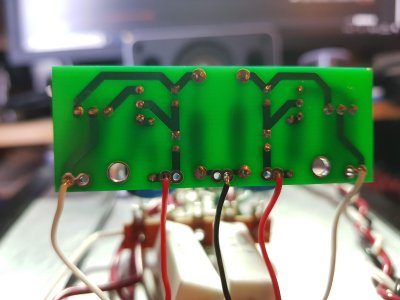

It would also possibly help to see some photos of the top and bottom of the small PC board, just to be sure that everything is looking OK there.

Reply #2 on: September 23, 2018, 05:49:28 AM
I found the dry joint, it was a black wire in the jack socket. I re-flowed it and not it is attached not.

Reply #7 on: September 23, 2018, 06:07:10 AM
Reviewing your photos, you have a backwards transistor.

Reply #8 on: September 23, 2018, 06:11:25 AM
Ahh, Yep, I see it.
Q1B?
