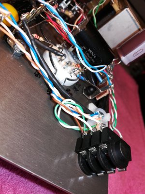

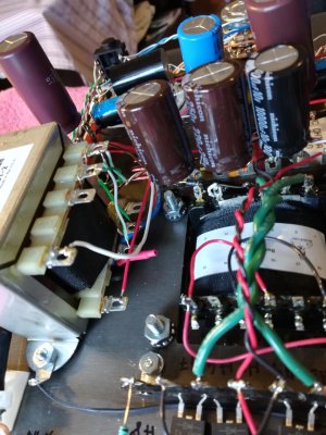

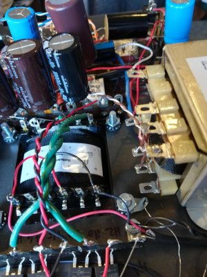

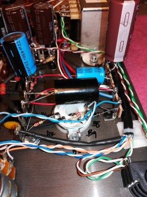

    • Posts: 20203
Reply #4 on: October 04, 2018, 04:31:17 AM
I am thinking the CAT6 cable is doing that, because I ruined the CAT5 that comes with
the kit. So I used a differrent one, a CAT6, the build is similar to CAT5, the difference is
in CAT6 each of the 4 twisted pair (stranded copper wire) is wrapped in foil, and all together shielded with coaxial-type
wire. How do I get a new length of CAT5 that comes with the kit?

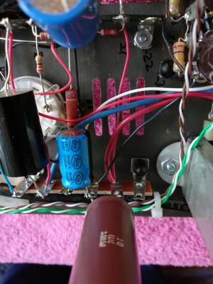

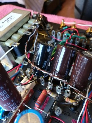

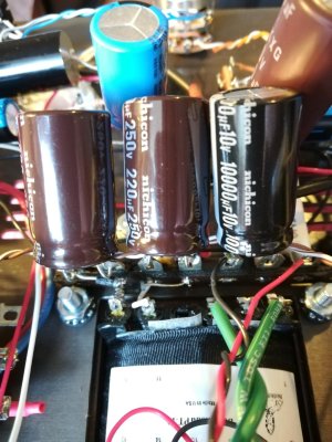

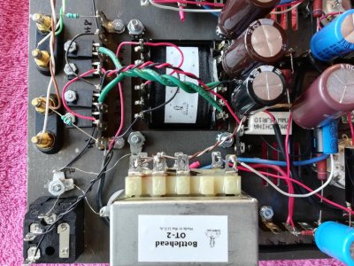

This is not the issue.  CAT6 is a higher bandwidth version of CAT5.  Both can be shielded/unshielded.  Neither is going to magically cause your amp to hum.  Unfortunately, you have replaced the solid core CAT5/6 wire we provided with stranded CAT5/6.  In our previous experience, this can cause some reliability issues down the road if all the strands are not well captured in each joint.
The site can accept 15 photos, you may just need to put them in 2-3 posts.
Are you using the SEX amp with speakers or headphones?  Which model(s)?  Which Arcam DAC are you pairing the SEX with?

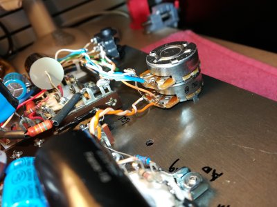

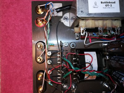

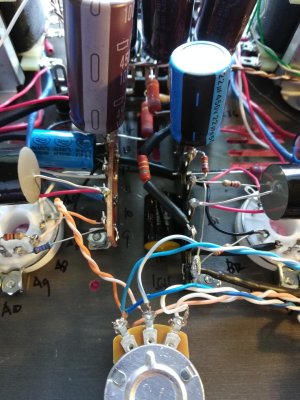

Within the couple of photos you've posted, all I can see is that the diodes on the "H" terminal strips need to have their leads trimmed where they come out of the back of the terminal strip.
Offline roycruz23
    • Posts: 30
Reply #5 on: October 04, 2018, 06:12:42 AM
I use headphones. I have no plans of using this amp with speakers. Matter of fact, I wanted to bypass
S.E.X. potentiometer and use my Hagerman Clarinet tube preamp as the control.

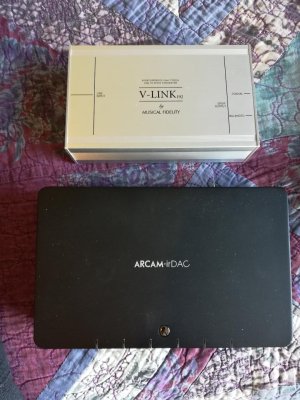

My set up is- Macbook/iTunes/USB out to V-Link 192-->ARCAM irDAC-->+/- Hagerman Clarinet tube preamp-->S.E.X.
I am sending pictures on installment.
Thank you,
Roy
Offline roycruz23
    • Posts: 30
Reply #6 on: October 04, 2018, 06:26:51 AM
more pictures

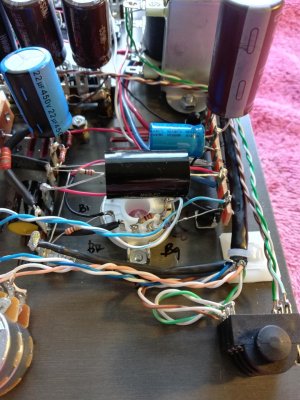

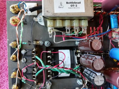

Offline roycruz23
    • Posts: 30
Reply #7 on: October 04, 2018, 06:30:16 AM
another installment :)

Yeah, this can happen with a lot of components leading up to the SEX (or any of our kits for that matter) that are all ungrounded.  There are two paths to get you up and running:
1.  Run a clip lead from a metal chassis screw on the SEX to the metal chassis of each of the components between your computer and the SEX.
2.  Get a DAC that has a 3 prong power cord that plugs into the wall.
We are happy to help with whichever direction you'd like to go.

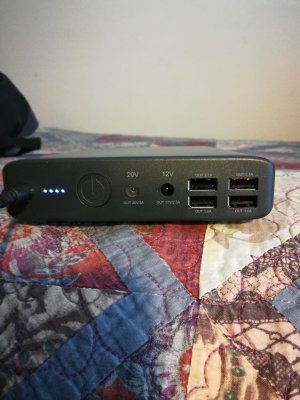

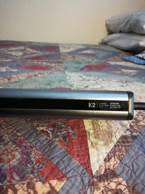

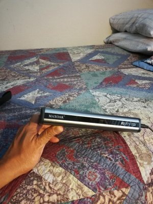

I tried running my Arcam irDAC both with the supplied wall wart power supply and a power bank (MAXOAK) with 12V DC, 1.5V DC output. The power of V-Link also comes from the power bank (1.5V DC). I also run a ground wire on both Hagerman preamp and S.E.X. I tried running with and without the Hagerman tube preamp, but the hum is still there. Any thoughts?
