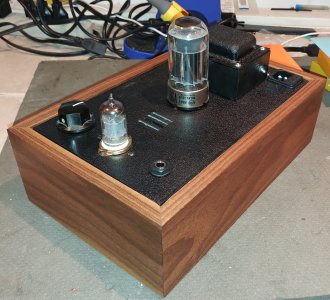

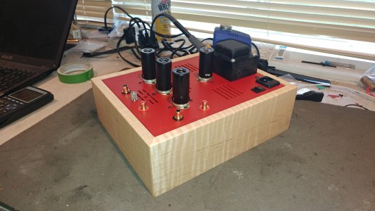

Powder coating will be quite durable as well, especially if you pick a textured powder.  That is what I use for anything I make for myself.
