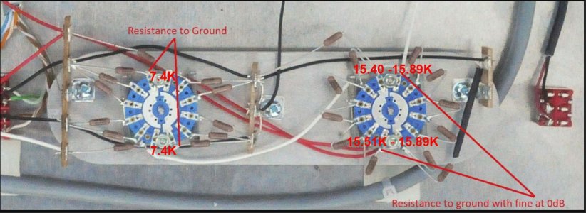

Offline ideal.hat
    • Posts: 115
Reply #8 on: October 20, 2018, 09:53:40 AM
Let's try this:
Let me know each of these 4 resistances.
Here you go. I did put Fine to 0db as instructed.
Gudmundur Asgeirsson
Bottlehead experience 4 out of 10.
I work as an IT administrator
Offline ideal.hat
    • Posts: 115
Reply #9 on: October 20, 2018, 09:55:54 AM
It also seems strange that if I put the volume to MAX on the Mainline and the computer source to 100% volume, its not "that" loud. It is louder then I would like to listen to, but its not like my Crack that would have blown my head clean off.
    • Posts: 20278
Reply #10 on: October 20, 2018, 10:09:14 AM
I should also check to be sure you have nothing plugged into the inputs when you're making these measurements.
The 15K reading is just plain wrong.  With the fine switch at 0dB, then the series string of resistors on the coarse switch can be measured.  There is about 25,000 ohms of resistance here.
I would strongly suggest measuring each resistor on each switch to be sure they are all in the correct spot.  I do not believe that they are.
Offline ideal.hat
    • Posts: 115

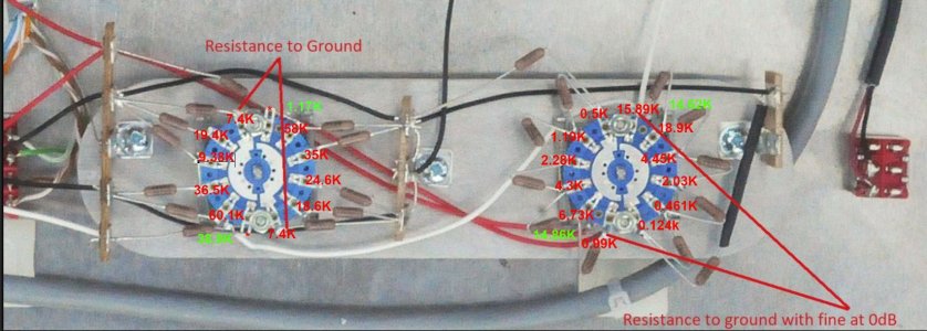

Reply #11 on: October 20, 2018, 10:41:41 AM
I am afraid that my measurements are all over the place. If you take a look at my latest attached picture, I have different values that I gave to you earlier.
I am an unexperienced beginner with a cheap multi meter. Can this picture tell us something?
PS: I am using ground on Terminal 7 when I take these measurements.
« Last Edit: October 20, 2018, 10:46:17 AM by elgringo81 »
    • Posts: 20278
Reply #12 on: October 20, 2018, 11:12:11 AM

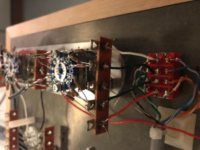

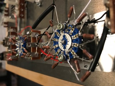

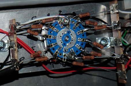

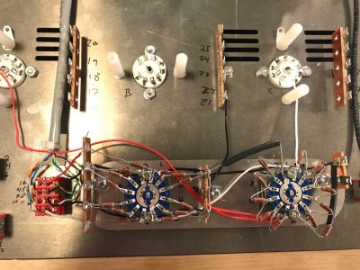

Yes, its most likely a mistake on my site. But I took good care to use the resistors accordingly to the manual and the paper that the resistors came on with their resistance and also model number. I though to my self that its best to try not to mess this up because its not going to be so fun to troubleshoot :)
Here are the pictures of the attenuators. Let me know if you would like me to make more pictures.
Please not that there is a loose white wire  below and between terminal 1 and 2 on the Coarse attenuator. I have fixed that now.
« Last Edit: October 20, 2018, 11:21:19 AM by elgringo81 »
    • Posts: 20278
Reply #14 on: October 20, 2018, 01:18:00 PM
The solder joints at 6 and 8 might be part of the problem.
The white wire leaving the coarse attenuator is not soldered at the attenuator.
Of the resistor values that I can read, they look to be in the correct places.
