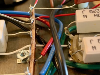

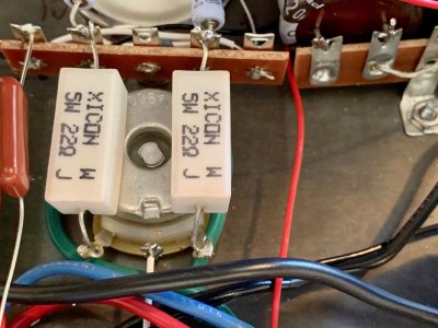

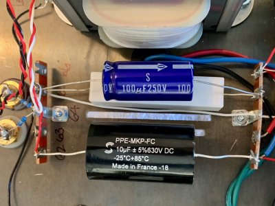

Is the 100uF axial capacitor oriented correctly on that side?  Are any of the legs of the hum pot touching the chassis?

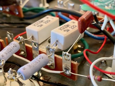

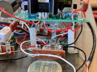

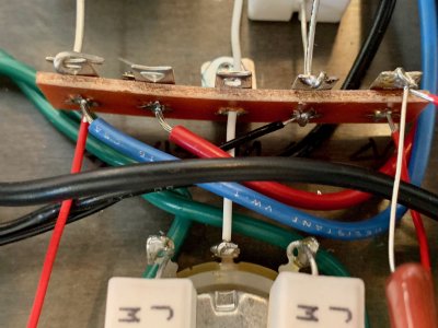

Your pictures are teeny tiny, I can't see anything in there.  If the forum is bugging you about file size, you can put a couple on a post, then post the rest separately.
The hum pot is the 10 ohm one with the 22 ohm resistors attached to it.

Reply #4 on: November 03, 2018, 03:38:50 AM
OK, larger...

10U doesn't look to be soldered.

Also desoldered 10U and 14-23U

That's REsoldered
