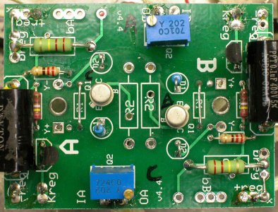

Offline Lance
    • Posts: 7
Reply #6 on: November 15, 2018, 08:14:25 AM
Hi Paul,
here is a picture of my Reg board. Let me know if you see anything funny. (besides the solder that needs to be cleaned up!)
I wired with my own silver wire with the same color insulator, so I did not include a pic of my own build.
I did however carefully make sure that the tube sockets and boards are all wired correctly including the resistors and caps on the tube sockets.
The "B" tube contacts did look pretty tarnished. If they are not silver plated, could that be a failure point?

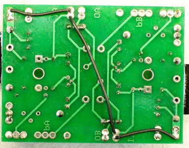

    • Posts: 20278
Reply #7 on: November 15, 2018, 09:12:29 AM
How about the bottom?
Offline Lance
    • Posts: 7
Reply #8 on: November 15, 2018, 10:36:18 AM
Here is the back side of the reg board
    • Posts: 20278
Reply #9 on: November 15, 2018, 01:01:22 PM
I would be extra sure that the two legs of the trim pot on the B side are well connected together (they look great on the A side).
You seem to be stuck really close to the base-emitter voltage, try turning the bias pot on the offending side 5 turns one way, then measure the DC resistance on the bottom of the board between the two pins soldered together and the third pin on the pot, then rotate 5 turns the other way and recheck.  I think if your pot was somehow stuck at 0 ohms that you might run into this issue.

    • Posts: 7
Reply #10 on: November 15, 2018, 03:52:23 PM
Hi Paul,
the trim pot is soldered well and has full value range.
I did clean the "C" tube pins a bit and gave the circuit another try.
What was odd was that now the "C" side bias could only be adjusted up to 125V!!!! Still the exact same issue with the "A" side.
