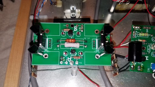

I would recommend posting photos and we can give you an idea of what's going on.
The high voltage at the Kreg terminal suggests possibly swapped R1 resistors on the C4S board, a misplaced jumper, or cold solders.

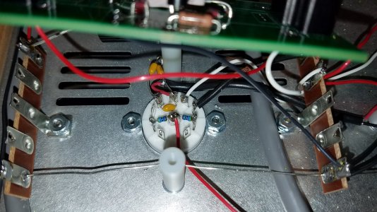

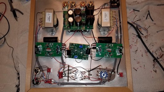

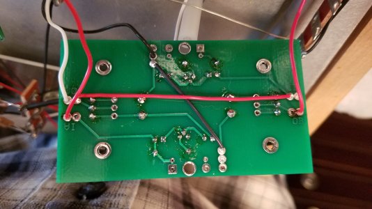

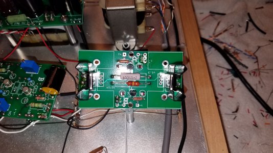

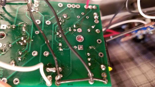

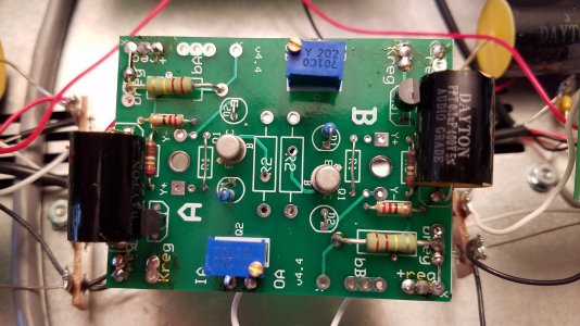

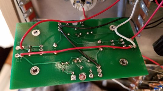

Here are some photos.  I can't get the hole bottom of the regulator board without desoldering some wires, but I was able to get part of the bottom side of the regulator board.
I checked the resistors on the C4S boards.  R1 on the A side on both boards meassure 37 ohms, and R1 on the B side on both boards measure 50 ohms.
Paul, you mentioned the voltage being high on Kreg, but Kreg on the B side is within range, while Kreg on the A side is a little low.  Am I misreading something?

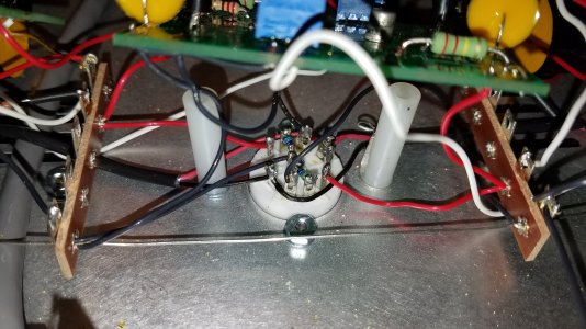

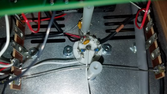

Additional pictures of the sockets.

Yeah, then no current is being drawn by the 6C45PI.  You can resolder pins 4 and 5 on the 9 pin socket to ensure that the heater is well connected.  The other super common issue that will cause this condition is underheated solder joints on the MJE5731A.
