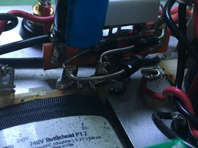

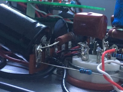

Reply #5 on: December 10, 2018, 07:14:56 AM
Paul Birkeland: Thank you
I still leave it on the desk in my own room (which uses home power supply). The noise has only recently appeared (after about a year and a half S.E.X had been working very well). Electrical equipments in my room weren't changed during that time.
Electrical-interference-like noises often appear randomly without any pattern.
I tried to turn off all electrical appliances nearby (including light bulbs), but the noise was still there.
I think it may be because the solder, capacitor connections, electric wire,etc. were physically impacted during use which cause it to leak, but I'm not sure about that.
So I want to have a Manual CD or PDF file for safer rebuilding.
And I also want to try upgrading such components like the volume potentiometer, the Russian teflon caps or the Mundorf SGO, according to experiences shared on Bottlehead Forum and Loquah (from Head-fi) ... for a better audio experience as well as the fun of DIY that Botthead can bring.
I'm really interested in this, and that was the reason that brought me to Bottlehead, instead of choosing a fully assembled head-amp.
But the lack of Manual CD made my dream impossible.
So, if by ordering spare components at Bottlehead.com that I can get my Manual CD or PDF file, or if anyone has a way to get the Manual then please help me.
Thank you very much

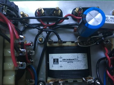

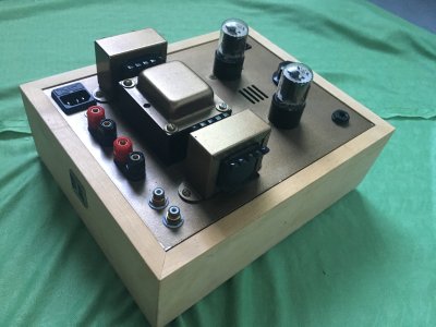

P/s: The image is taken without any other light from electrical appliances and with the S.E.X being disconnected. (I took the image with flash light from the camera.) In that state, the S.E.X 2.1 still generate noises, while the O2 amp (connected to the same power) doesn't.
I'm sorry for not being able to post any comments sooner because the VPN and errors like ERROR 500 (which I do not understand) did not allow me to post.
« Last Edit: December 10, 2018, 07:32:46 AM by quy lam nguyen »
    • Posts: 20203
Reply #6 on: December 10, 2018, 07:27:58 AM

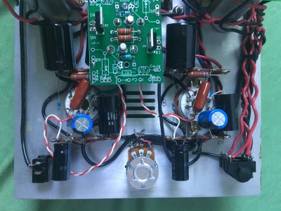

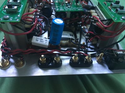

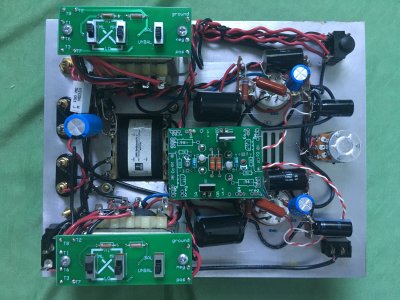

Has the amp been dropped?  I do not see any evidence of anything leaking in any of the photos you've posted.  I would strongly advise against completely rebuilding the amp, as this is a legacy kit with some parts that are going to be very hard to find or are potentially discontinued.

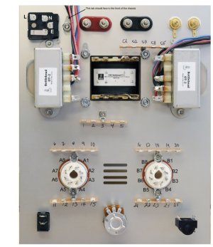

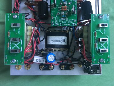

Are the terminals numbered on your amp?  I can provide some basic voltage checks to ensure that your amp is operating properly if you'd like.

"Are the terminals numbered on your amp" - Did you mean the handwritten digits written by the builmers behind the top plate? Those numbers are still there, but some digits are not clear. I tried a lot of different ways to try to identify the cause of electrical noise, and I realized the noise only ends when I remove the tube :)

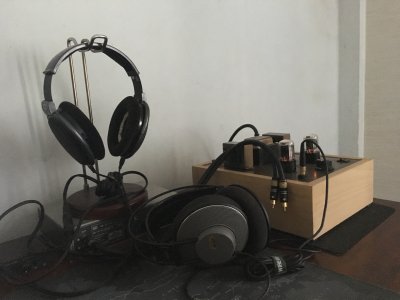

Just out of curiosity, what headphones are you using with your SEX amp?

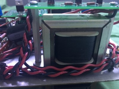

You would have to talk to the boss about a flat rate repair.  I can see some hardware used to mount the power transformer that's absolutely not supposed to be there, but otherwise the kit looks stock.  It may be that this hardware is part of the issue.

I have some headphones (Sennheiser HD600, HD650, Foster, Beyer DT770, AKG K240). But I often use my AKG K501, because I feel it is suitable for my favourite classical type of music)
I have used my S.E.X 2.1 with a lot of different headphones. In a year and a half after purchasing the amp, it has worked just fine with almost any type of headphone. Noises just appeared recently

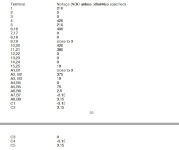

    • Posts: 20203
Reply #10 on: December 13, 2018, 07:01:40 AM
Terminal numbers.
    • Posts: 20203
Reply #11 on: December 13, 2018, 07:03:00 AM
Voltages.  (Terminal 3 is a good one to use as ground)
