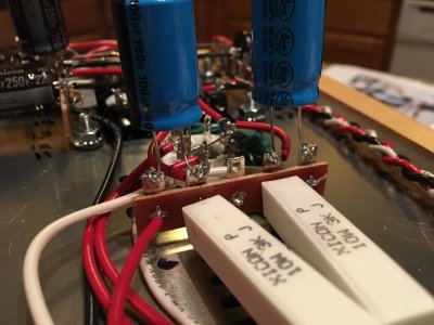

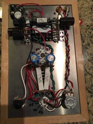

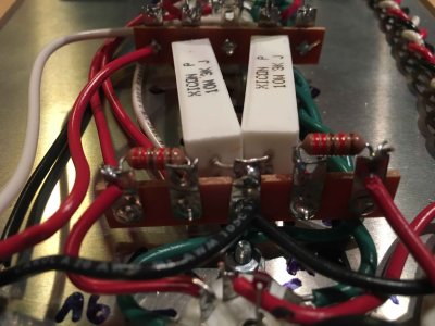

I'd be interested in seeing some photos of your build, and also of knowing your voltages at terminals 1 and 5.
Offline tdahlen
    • Posts: 6
Reply #4 on: January 19, 2019, 06:18:23 AM
Here are my measurements and a few pictures.  Let me know if you need a better look at an area.

Reply #5 on: January 19, 2019, 06:20:03 AM
You have a wiring error at B5/B6.

Reply #6 on: January 19, 2019, 07:09:11 AM
Yep, that was it.  I corrected the wiring at B5 and now the voltages are measuring correctly.  Thanks for your help.
