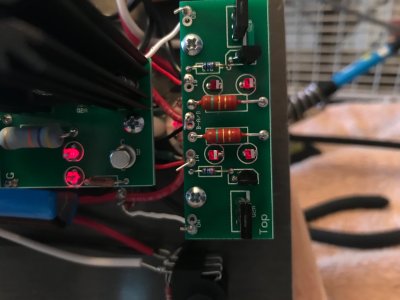

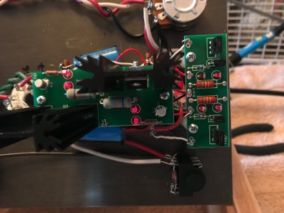

1)  I know the instructions say it is never the LED that is bad, but I have one LED out and am within range on all my voltage checks and resistance checks.  The amp also sounds good with the exception of a low consistent buzz when not playing music.  Should I still be worrying about the LED that is out on my small circuit board (pics attached)?

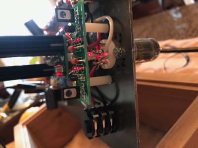

2)  The low buzzing I am hearing I am assuming is due to a bad solder joint?  I noticed if I tap on the top of the Crack I can hear a muffled sound in my left channel.  The low buzz also seems to be coming from my left channel.  It is unnoticeable when listening to music for the most part but it will build to higher volumes at times.  Just wanted to see if anyone had any ideas on troubleshooting.
It's not the LED, it's the backwards transistor next to it.  (You also wouldn't have passed your voltage checks on the small board, OB will be about 50V, which is too low)

Thanks for catching, Paul.  Not sure how I missed that.  My voltage on OB was 59v so you are correct it is in the 50s, but within the +/- 10% of 60v so I figured it was fine.  I will try and fix when I get home.
Also, any thoughts on how if I just tap on the top of the chassis I can hear the tap albeit muffled in my left channel?  I also will occasionally get a buzzing that builds and if I tap I can get it to go away.
Appreciate all the help and thanks again.
    • Posts: 20295
Reply #3 on: January 28, 2019, 04:46:24 AM
A buzz that goes away when you tap the chassis is nearly always a loose solder joint.
