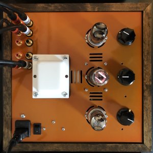

Finished the Smash today! That was a fun build.
The top chassis is finished in the same candy orange as my Reduction. I'm waiting on white knobs to match the color scheme.
One general question: should the OD3 glow purplish? Is that expected?
One quick question about the Smashquiet (and Mourquiet) upgrades: Does Bottlehead have any interest in selling me either custom white plates, or the CAD files for the faceplates so I can take them to FrontPanelExpress or a local Makerspace? No worries if not - I can try and replicate as best I can on FPE’s CAD software. Just figured I’d see if there was a way to buy from you all first and save some time on my end.

Alright, thanks. It's a little daunting since they don't appear to offer proofs and that part looks like it's about $95 if I have them etch and powder coat also - that's a steep price for a mistake.
Everything good with the 0D3 glowing purple?
Yeah, tell me about it!  I have had plenty of $500+ mistakes over the years.  If I had a Front Panel Express file laid out with the lettering in their font, I would just send that to you, but I did the artwork in Corel Draw.
Yes, that's part of normal operation.
I do actually think that the black panel would look great against the orange chassis.  You'd have a bit of a KTM color scheme going on.

Thanks for the reassurance on the glow.
There are definitely worse things in this life than having a black faceplate. I think I'll install it for now and just have a white, orange, and black scheme. I'm having a hell of a time finding 35mm white knobs anyway.
Thanks for the help, guys! Loving the Smash so far!
