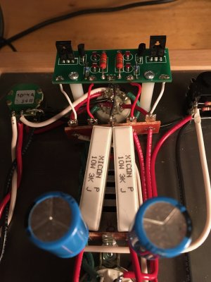

Reply #1 on: March 21, 2019, 04:11:28 AM
Can you post some photos of your build?

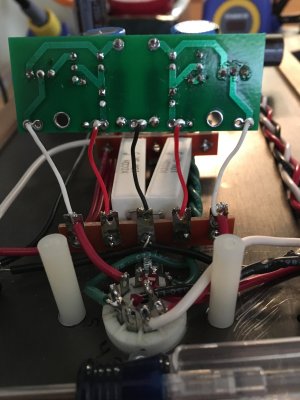

Reply #3 on: March 21, 2019, 10:24:27 AM
It wouldn't hurt to put the stock pot back in, but it may not be necessary.  Can you unscrew the screws that hold the board on, flip it up, and take a photo of the underside?
Offline jake111
    • Posts: 98
Reply #4 on: March 21, 2019, 01:36:53 PM
Photo:
Reply #5 on: March 21, 2019, 01:52:23 PM
It probably wouldn't hurt to just reflow the joints on that side of the PC board.

Reply #6 on: March 21, 2019, 04:28:58 PM
Reflowed and no change.
