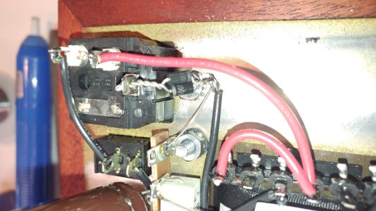

I have determined that a simple ground breaker can be installed in the Crack to prevent this noise from being an issue.  It's just two antiphase diodes that take the place of the buss wire between the IEC ground lug and the chassis grounding tab.
If you're going to buy diodes to do this, I would recommend a 2A rated diode that is not a Schottky diode.  This is also a place where you don't want to accidentally use zener diodes.  STTH2R06 looks like a good choice for this.
