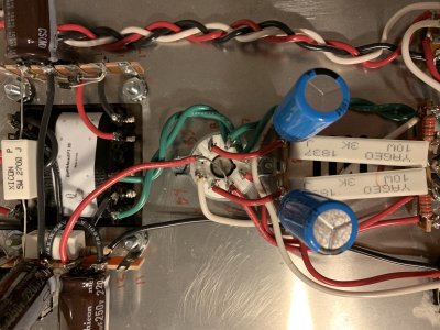

Full disclosure - this is my first amp build, so I have no doubt this is my mistake somewhere. I have doubled checked all the directions, and I will go back through and triple check them as well. However, the amp passed all resistance checks and voltage checks during/following the build. Worked great at first for a few minutes, then I started getting popping in the right channel. Found one loose solder, fixed it, that didn't solve the problem. I discovered that the LED closest to the middle of the amp (attached to A8) lights up ten seconds after amp is turned on, but consistently goes off again after the amp is on for three minutes. I re-soldered this LED and tried to make sure there is some play in it. It was pretty tight before, but now has some room to move around. Didn't solve the problem. Just to clarify, the other LED (attached to A3) stays lit without issue. Here are the voltages I'm getting once the LED turns off as well as the initial voltage checks following the build.

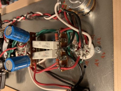

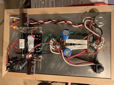

Here is a pic of the final build before I re-soldered said LED. And here is a closer one of the LED while off. I did poke around with a wooden stick, and once the LED is off it stays off. But I may not have poked the right connection to get it to flash. I'll give this another shot in a bit. I appreciate the quick response!

Terminals 2L and 5L sure look like they could use some extra heat.  3U looks like it could use some extra solder and some extra heat.

100 volts at terminal 10 suggests to me that terminals 9 and 10 are shorted. Based on your first photo, my guess is that the body of the 100 uF cap that connects 9U and 10U is touching the tops of those terminals.  The manual calls for the body of this cap (and of the cap connecting 6U and 7U) to be spaced a 1/2" from the terminals.
Otherwise, I would look for another short connection between 9 and 10.

I'm was going to cautiously call this solved. I checked all the spots mentioned above. Clearence at 6U & 7U as well as 9U and 10U is greater than it appears in the picture, and seems to be in spec. The pic is a bad angle for sure - sorry about that. I heated or added solder to all the headphone jack connections, as well as 3U and 7L and 9L just to be safe. However, I noticed the problem still occured, and I had the multimeter attached at 12U to check the voltage at 10. Voltage there is now 0 as it should be. So the voltage problem is solved. However, when I removed the black alligator clip, the LED immediately went out. I started tapping around 12 and 13 and found a lose connection at 13. Just to be safe I heated up 12 as well. Turned the amp back on and it ran for several minutes with no issues. Just enough to give me hope. Then the LED started flashing off again. When it does, I get a bunch of terrible static through the headphones so it's very easy to detect. Don't worry - using an old, cheap pair of iem's, so no worries about damage. I started tapping around again, and each tap brought the LED back on no matter where on the chassis I tapped until it eventually clicked off for good after ten or so seconds. No tapping of any kind, anywhere revived it.
I let the amp cool down and plugged it back in. It worked again as normal for about 3.5 minutes, then I got the static again. This time, I think I have tracked it down to one of the following: B5, B2, or B3, with most of my suspicion on B5 and B2. Pressure in between these seems to eleviate the problem, so I need to check these solders.
