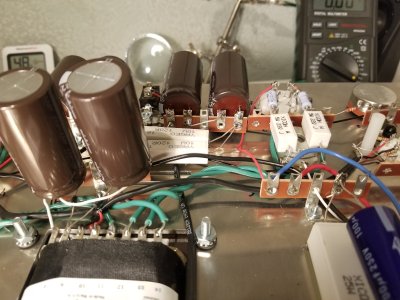

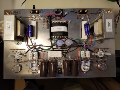

Howdy!  I'm assembling my Kaiju, and I've reached the High Voltage Power Supply Test section.
All assembly and testing up to this point has been successful.
Multimeter black wire it clipped to 1U.
When I measure the voltages, I expected:
10U - 250VDC+/-20%
14U - 490VDC+/-20%
15U - 250VDC+/-20%
When I power on the unit with the multimeter across any of these points there is initially no voltage, but it begins to climb at ~0.01VDC per second.  When power is disconnected it begins to drain back to zero.

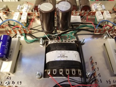

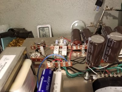

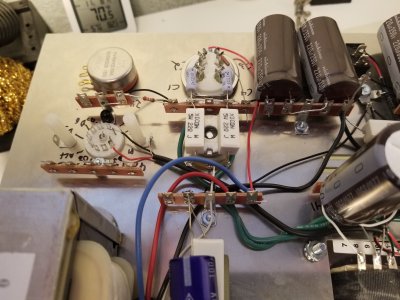

I've attached pictures of the unit as measured.  I'd love some help diagnosing the issue.  Any ideas?
Let me know if you'd like other images and I'll grab them and upload them.
Cory

Online Jameson
  • Intern in Chief
    • Posts: 917
53 and 65 don’t look soldered or attached well. Unsure if that’s the cause (or if they’re even meant to be soldered at this stage).
Jameson O'Guinn
Managing Partner
Deke609
Ditto for 14U and 13L.

From what I can tell 53U and 65U are not meant to be soldered yet.
14U is definitely not supposed to be, that is mentioned in the instructions.
13L is soldered, but doesn't look it in the pictures.  I'm going to reflow it just in case it's a bad solder joint.
Deke609
Maybe wrap the lead around the terminal and crimp it - from the photos it doesn't look firmly attached.
    • Posts: 20260
You can use a bit more solder on most of those joints.  For the lower holes on a terminal strip, it's reasonable to fill them with solder.

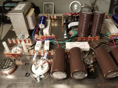

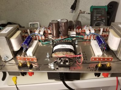

I went back through all the steps for the power supply, resoldering every joint as I went to ensure they are good.
The problem is still the same.

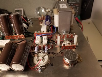

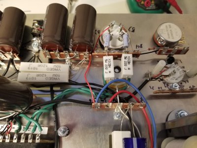

I took a fresh set of images to show how it looks at the moment, which I am attaching.
I can't find anything that I have obviously done wrong (no missed steps or incorrect wiring).  I must have made an error somewhere, but I can't see it.

Deke609
That's a head scratcher. Are you sure you're measuring DC voltage and not AC voltage? Measurements in the tens of millivolts could just be AC ripple.
cheers, Derek
Deke609

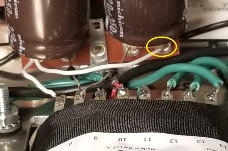

Andif that's not it, maybe double check the white wiring of the first two caps after the power transformer. In the circled connection in the attached pic it looks like the insulated portion of the wire extends into the joint. Can't see the connection to the other cap, but maybe check that too.
[edit: forgot to attach pic]
cheers, Derek

Offline cjohannsen
    • Posts: 9
Success!
Derek was right, the white wire at 41L was not cleanly seated.
10U: 263 VDC
14U: 519 VDC
15U: 277 VDC
Thanks everyone!
