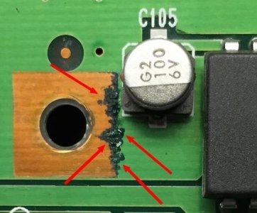

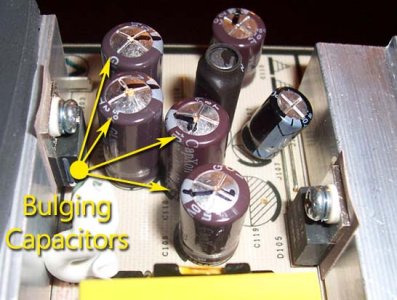

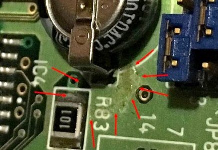

More generic and mass-produced consumer gear, though, is a whole different story!  I've replaced tons of bad caps in solid state gear (amps, televisions, preamps, digital pianos, etc).  While there are some clear signs of a bad cap (I've attached some images below) such as bulging and leaked electrolytic fluid, many caps simply fail without any visible signs at all.  If you see anything like in these images, that cap is definitely bad and needs to go.  But, the inverse is not true: a cap with no visible symptoms cannot be assumed to be problem free in a piece of misbehaving equipment.  As far as I know, there's really no definitive way to locate a bad cap while it is mounted in a circuit.  Even removing the cap and subjecting it to measurement with one meter or another is not a definitive test.

Sorry, Paul - I don't have any experience with the long life surface mount caps.  I've only played with the cheapo ones that mass manufacturers stick on their boards.  With my digital piano, the PSU board had small-can radial lead electrolytics and the digital synth board was all tiny-can surface mount electrolytics, like in the third image I posted above.   I had to replace all 107 caps in order to bring it back to life.
