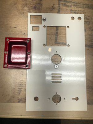

I had the top plate and trafo bell powdercoated (they coated all surfaces, was going to cost a fair bit more if they masked anything).  I just want to confirm that I need to scrape the coating off the bottom of the plate at terminal 3,8, and the #8 safety ground bolt? Any other places? The transformer is isolated from the top plate so I don't need to worry about scraping any off the underside of the bell or plate on those 4 holes, correct? Possibly run a 1/4" drill bit by hand through the top plate transformer mounting holes if the fiber washer shoulder doesn't fit?
Thanks for any help!

You don't need to worry about terminal 8, but certainly 3 and the ground screw.  Passing the 1/4" drill bit through those holes is a good idea, as the shoulder washers are a tight fit. I would also scrape off a bit of the coating on the bottom side of the transformer cover around each hole.

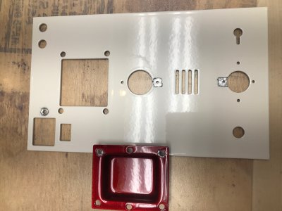

Here's what I have so far. I sure hope the bell doesn't end up rusting in those spots.  It was $30 just to get the bell coated.

You scraped 8, but not 3.  You need to scrape 3, but not necessarily 8.
And that’s why I don’t even sand paint off when I’m tired. Jeesh 🙄

Yeah, it would have been enough to scrape the bottom side of the transformer cover, not the top side.  I would dab a little bit of clear coat over those spots, as they will probably rust.
That is the bottom side 😁. Pic makes it hard to see.

Paul, is there any worry about the bottom part of the bell where I scraped rusting? Maybe a dab of thin primer that the washer can easily bite through?  It definitely wasn’t biting though the powder coat as I cranked down a toothed washer and checked before scraping any off.
