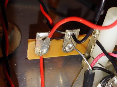

16U is the incoming high voltage from the power supply board and 17U is ground.  There are no components between them that could catch on fire.  If there is damage in this area, I would suspect debris from the build or a short from something like improper flux and/or solder used.
You could certainly post photos of the damage and we might get a better idea of what's going on.

I've attached two pics here - one of each side of the affected area.  I've already cleaned off some excess flux, which I assume was the issue.  I'm now looking for other places I may have additional flux.

Did you use any additional flux other than what came with the rosin core solder?  There are fluxes out there that are conductive and will do exactly what happened to that terminal strip, but rosin won't.

Yes, I did use additional flux. I went through and cleaned up a bunch of it, which I believe fixed my issue.
    • Posts: 9782
We're seeing more cases of builders applying extra flux when working with flux core solder lately. Don't do this, the flux in the solder is more than enough. Additional flux quite often creates the problem described here. Inadequate soldering iron heat is more likely the problem than lack of flux if joints don't flow well.
