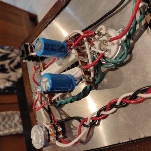

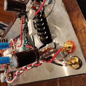

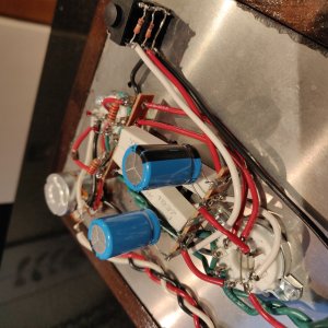

I've also attached some pictures. Hope they are clear enough.

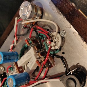

Reply #3 on: August 24, 2019, 10:05:12 AM
More Pics

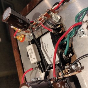

Reply #4 on: August 24, 2019, 10:09:12 AM
More pics!

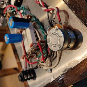

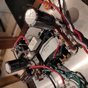

Reply #5 on: August 24, 2019, 10:19:40 AM
And another...
    • Posts: 20258
Reply #6 on: August 24, 2019, 10:49:00 AM
A5 looks to not be soldered.
The junction of the black wires on the headphone jack does not look to be well soldered (and would definitely cause the problem you observed).
10L needs more solder (and heat).
The #8 nuts need to be installed so the power transformer doesn't fall out.

Reply #8 on: August 25, 2019, 04:35:42 AM
Paul, you are a total genius.
My creation has come to life.
No sparks flying and no distortion!
Thanks so much!
