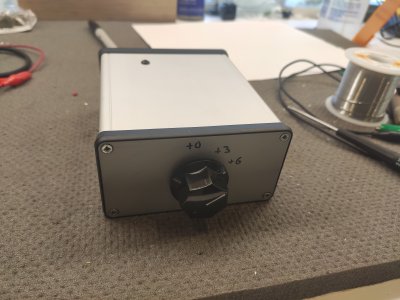

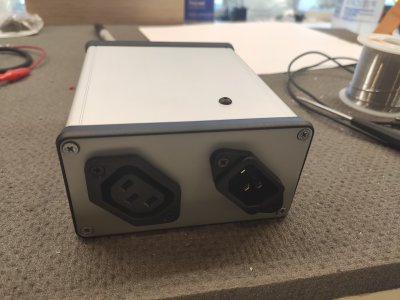

The easy way is to get a 120V:6.3V CT transformer with a 2A secondary, then wire it as a boost autoformer.  You can have +0V, +3V, and +6V with that transformer, just grab a 4P3T rotary switch rated to switch 120V AC.
I just built such a box for Alonzo a few weeks ago.
