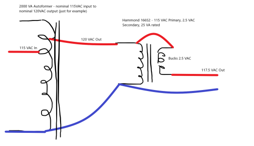

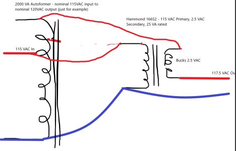

I did some quick reading on "bucking transformers" this morning, and if I'm understanding things (big "if" here), it looks like I could use a high current 2.5VAC filament heater transformer as a bucking transformer - is that right? The Hammond 166S2 is 25 VA rated, primary is 115VAC, secondary is 2.5VAC C.T. From what I read it sounds like I can wire one end of the primary to the secondary so that the secondary is out-of-phase and hence "bucking" 2.5VAC. And since it's only bucking 2.5VAC, the 25VA rating means it good for a max of 10A. I think I'd feel more comfortable going with 9A or even 8A just to be on the safe side.
Is this right?
cheers and many thanks, Derek

Deke609
Reply #12 on: September 17, 2019, 05:27:48 AM
Many thanks PB. I'm not quite sure what configuration you are suggesting. Here is what I was thinking. Is this the same or equivalent to your suggestion? [Edit: you can scroll across the image with arrow keys to see the right hand side]

    • Posts: 20295
Reply #13 on: September 17, 2019, 05:54:54 AM
No, the primary of the bucking transformer needs to be connected to the incoming AC, not the output of the autoformer.
Deke609
Reply #14 on: September 17, 2019, 06:20:22 AM
So: Mains -> Bucking -> Autoformer?
