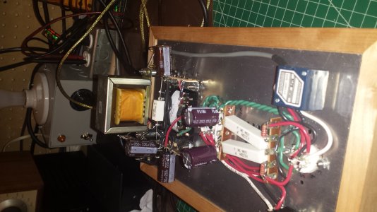

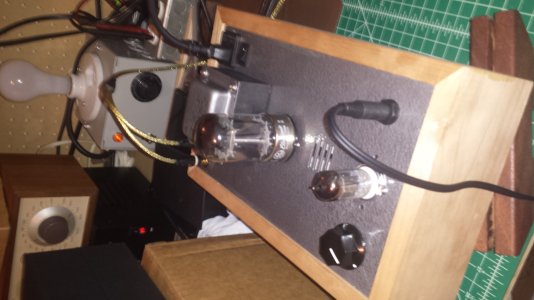

Hello all,
I just completed my Crack amp and I am quite pleased!
It's very quiet, Dynamic and has plenty of output. I'm using Sennheiser Hd 650's

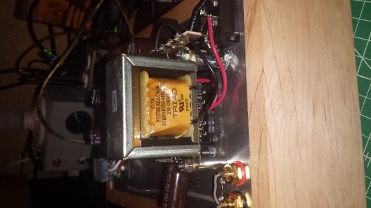

I built it almost stock, I knew that I wanted to use a choke in the psu and wanted it in place of the final resistor.
Therefor I installed and wired it up during the build because it would be a pain to do so later.
I also installed the ground breaker diodes from the get go.
the final change was to use an alps pot removed from another project.
all resistance and voltage checks were normal using a variac set to 120vac.
My speedball kit is assembled and sitting in a box, frankly I like the way it sounds now.
I'll listen to it for the month of October and decide about the speedball then(i'm sure I will try it).
It is a shame though that the chassis is not a little wider as I will eventually install film caps on the outputs.
Having said that I am quite pleased with the amp in its current state.
Well done Bottlehead, all inclusive.

A few pic's
