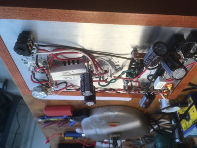

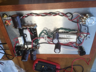

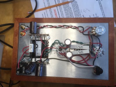

I've also attached a number of views of the build. Note that these photos were taken before I replaced the 207ohm resistor that runs across the power supply. I'll be happy to provide other views as needed.

You absolutely have to clean up that green wire that feeds A4/A5.  That's way, way, way too much jacket stripped off and if that touches the chassis for any prolonged time, your power transformer will fry.
You are missing the white wire that goes from the volume pot to the 9 pin socket.  I am surprised that this didn't tank your voltages in the process!

Reply #4 on: October 17, 2019, 07:48:03 AM
It looks to me like the bottom resistor on the 1/4 inch headphone jack isn't fully soldered on one side, the side facing the camera.
Deke609
Reply #5 on: October 17, 2019, 07:58:50 AM
Ditto. It doesn't look to me like it has been soldered at all on that side.

I added the missing white wire (Aargh. So embarrassing). Added more solder to the terminal on the output jack where the lower resistor was attached, added insulation to the green wire where it feeds A4/A5. No more hum. Just clean, quiet, beautiful music, even without burning in the new tubes.
