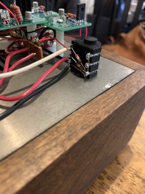

Here's a picture of the headphone jack. Now that I look closely the black lead coming from the potentiometer is loose as it passes through the lead in side of the headphone jack.... Is there any explanation for the T R S being soldered together on the other side?

I re-soldered the black wire into the headphone jack, and I took the wire off the other side just because. No popping noise anymore! Thanks for the tips.

The wires soldered together on the other side of the TRS jack need to be there.  These short the output when you have no headphones plugged in, which minimizes the voltage spike when turning on the amplifier.

Ah I see. I'll re-attach it.
