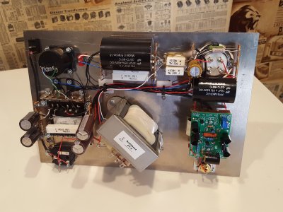

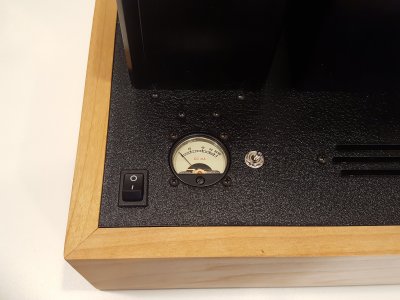

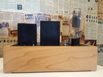

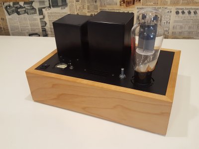

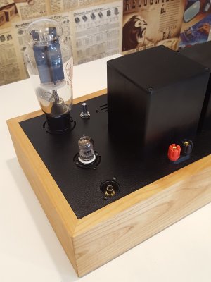

PB, PJ and I have been working on a new project for the past couple months. This is our new premium 2A3 monoblock amplifier. It is designed to run a broad range of 2A3 variants up to and including the JJ 2A3-40 by virtue of a two way switchable operating point. The current draw of the 2A3 in a given operating mode is indicated by the meter. It uses a parallel feed output stage and a cap coupled, shunt regulated driver stage. It uses the big OT-5 output transformer that we use in the Kaiju. I'm going to let PB weigh in on the performance specs of various 2A3 tube types, as he is the one who has been playing with them. Sonically it is a little more towards neutral than a Kaiju (a but less lower midrange/upper bass weight) and thus has a little bit more resolved sounding vocals and a wee bit more top end shimmer. That said, with similar circuits and iron both amps are definitely from the same sonic family. Universal power transformer, and a very low noise floor similar to the old Paramount monoblocks. Kit price is estimated at $2250 for the pair of monoblocks. Yes, those shrouds and the black finish are how the production kit will look.

More info please : what is the driver tube? how much power with JJ2A3-40? DC filament option? looks like 8X10 base size like Paramount?
    • Posts: 20176
Reply #5 on: November 02, 2019, 06:13:38 AM
The driver tube is the 5670.
7W @ 10% THD with the switch on the higher current operating point.  The Sovtek 2A3 that we will send with the kit will make 6.5W or 5W depending on the switch position.  I suspect the big EML 2A3 will also be around 6-7W, but we don't have a pair on hand to try out.  The fun thing about this amp is that you can go from the low current operating point with an RCA 2A3 to the high current operating point with the JJ 2A3-40 and go from listening to a 2A3 to 300B amp very easily.
The amp will come with DC filaments straight away.  The chassis is 10"x12".  The larger chassis helps fit the substantially larger iron, and it helps keep the amp running a bit cooler on the inside.  We are also providing the amp with film cathode bypass caps, and that requires a bit of extra space as well.
